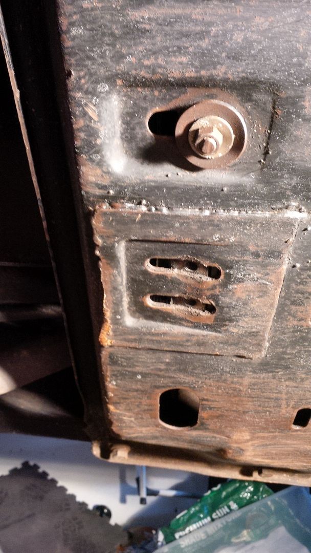

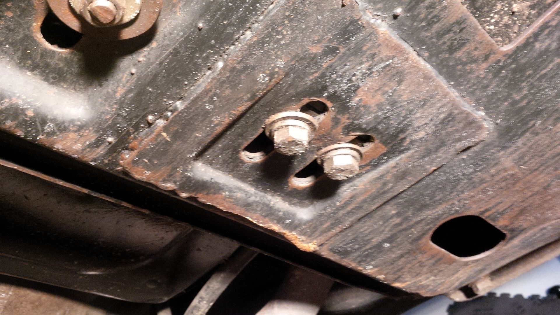

First step according to Brown Dog, and they STRESS this, is to remove the transmission bolts.
2. Instead of a block of wood, I'm using my Fister Fab Oil Pan skid.
3. Frank was right, I should have changed this when I had the manifolds out LOL. Look at all that crap in the way.
4. I did the bolt from the top first, then the nut off the long bolt, and then the stud on the mount. I had to play with the jack to get it lined up, but once I did, it the bolt came out relatively easily.

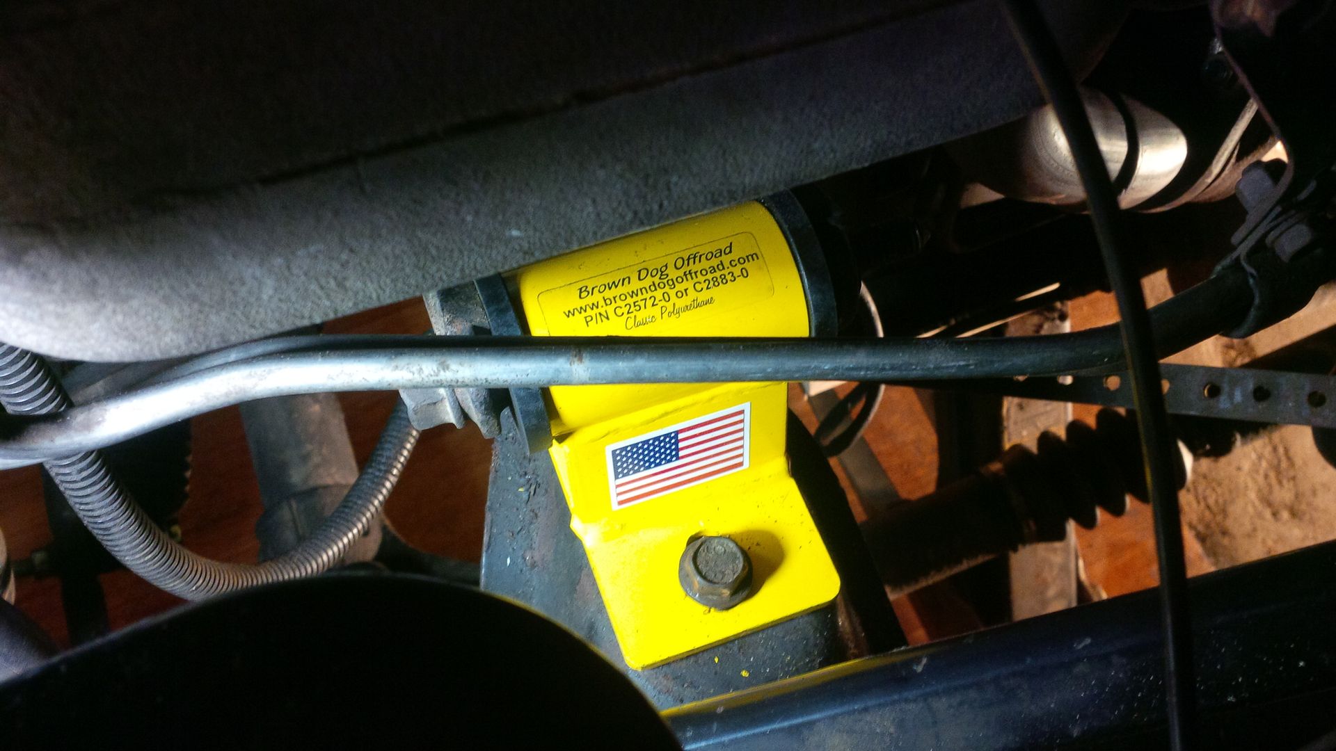

5. Drivers side - not bad. Brown dog said that it may be easier to remove the engine bracket and mount together. I didn't go that route. It just took several attempts moving the jack up and down to get it to line up. As Brown Dog said, they fit tight in the bracket, so some grease on the sides made it easier.
6. Passenger side - The Brown Dog instructions said that you shouldn't remove your alternator. You can see it in the bottom left corner of the pic. When the long bolt is pulled out, it hits the alternator. It's close but it's just enough to not let the mount come out... at first. Brown Dog was right, you just have to pull the bolt out as far as it will go, then wiggle the mount and it'll come out. Same with the installation. You just pull the bolt as far as you can, then the Brown Dog mount went in with a wiggle.
7. Make sure to reinstall the transmission bolts. I didn't have to mess with it at all. Once I tightened the Brown Dog mounts, the transmission mount was perfectly aligned. I'm running a Poly Transmission mount.
8. Last was to button up the air box. When I started it ran at high idle, also the brakes were weak, but had a hard pedal. I really thought I messed something up, but I just knocked off the vacuum line off the brake booster. Duh.
So in conclusion, they are a very well made American Product. The fit was perfect. Now, the choice of poly. There is no change in drive live vibes because the angles didn't change. There is a little more vibration at idle in gear. Not bad, and I have no intention to switch to rubber. Like I said, this is one of the FIRST things I should have done to Gorillacon.
