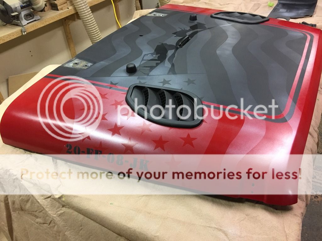

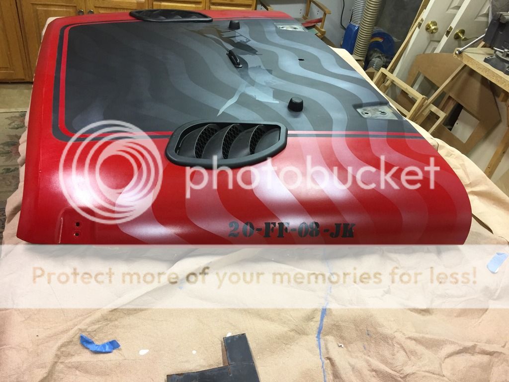

I wet sanded, primed, wet sanded, and painted, masked, wet sanded and painted the black parts of the hood red.
I used Duplicolor factory matching spray paint.
The numbers and lettering goes as follows:
20: for the way the US Army IDed MBs during WW2
FF: cuz I'm a firefighter
08-JK: cuz thats what it is

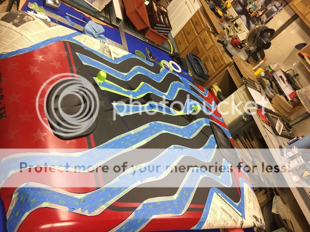

SO after thinking and pondering for quite a while I spent way more hours then I ever thought I would
laying out, relaying out, taping, and masking out an American flag design to ghost in.
Tonight I finally got around to ghosting in the flag.
I used my airbrush with pearl grey and pearl white highlights.
That took very little time to do.
Depending on how the light hits it you get varying degrees of the effect, some angles you can
barely see it, others it jumps out.
After a bit of touch up of the red where the tape lifted it in a few spots, I'll clear it and see how closely the red matched the factory color.

Funny thing is the ghosting in of the flag was the easy part.
Just about 10 - 15 minutes of actual paint application via airbrush.
I understand painting is mostly prep, but wow...
It took much more time that I had even imagined to layout and mask the flag.
I haven't had a chance to see what it looks like in the sunlight yet.
That'll show the full effect of the pearls in the paint.
