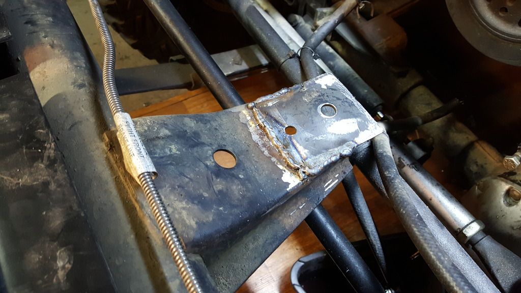

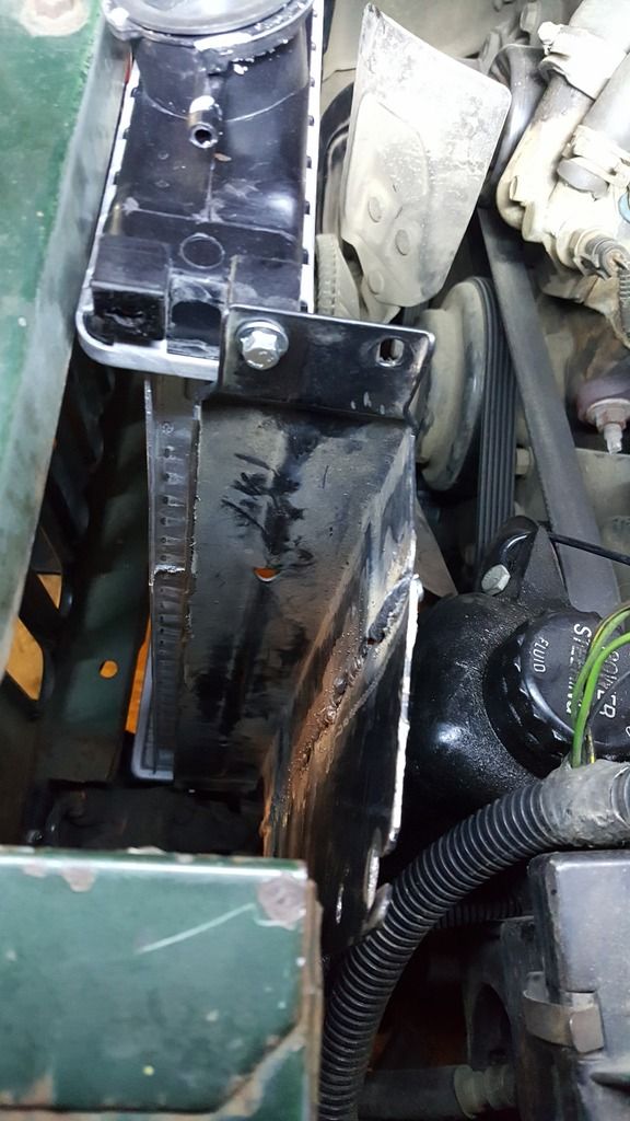

A few updates...
The radiator. I decided to go with the YJ radiator because it was new. You can see in the pic below that there isn't much room. I modded the brackets so it mounts in there nicely with about 1" clearance between the fan clutch and the radiator. Not sure what to do with the fan shroud yet. I have to weld up the final brackets.
Next the lower grill mount. I don't have the original mounting hardware, so I just welded on a plate to allow a bolt to go through and I'll use hockey pucks.
Having a few problems. First, when assembled and buttoned down, the passenger side of the grill is getting pulled down where it's about 3/4" lower then the drivers side. Either the tube fender or the tub is tweaked. Thinking of jacking it up by the tube fender to tweak it the other way, but that has "probably shouldn't have done" that written all over it. lol
Next, the Power Steering reservoir will need some custom mounts and it interferes with the air cleaner box, so that needs to be relocated or replaced. After searching around, I may do the Windstar air cleaner/Cowl mod.

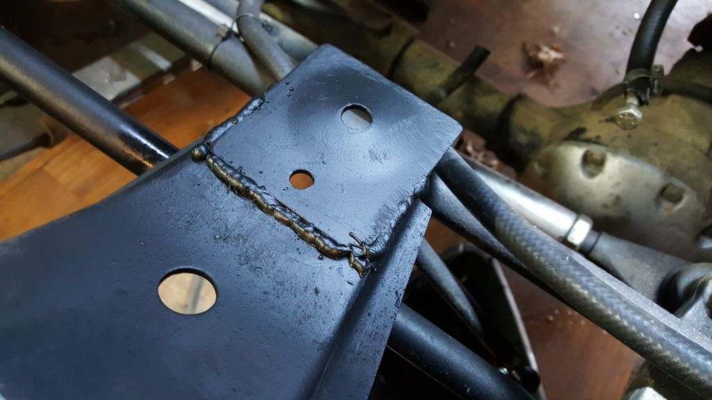

Yep, turn up the heat, looks like a lot of the weld is on the frame support, not your tab.

Slow down wire speed?
BINGO. When Alan and Pat said turn up the heat I got worried because it was maxed. I was using wire speed of 6 and getting those thick welds. I lowered the wire speed to 3 and it's melting much better.

The weld in the back is wire speed 6. The weld in front is wire speed 3.

Try doing a "C" or a "V" pattern having the end of the C or V touch the two different materials.  Also try doing small cursive "e", not my favorite, but works better for some.
Also try pushing the weld vs. pulling.  You will find yourself using both even though you will favor one.
Best way to practice welding is welding two pieces of material together.  Its hard to practice when its on a flat surface.
Jeep looks good.  If you have any CJ nose questions let me know.

what size wire.
voltage?
looks like 0 prep was done.  did you clean a spot for the ground clamp
