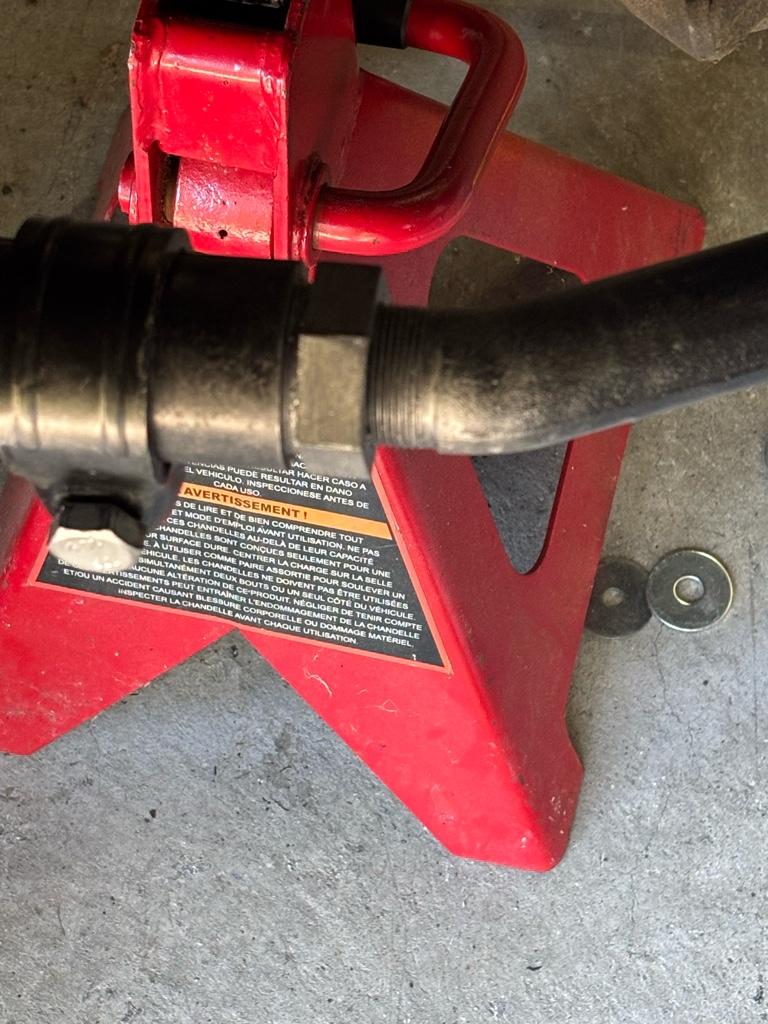

As you probably know I’m trying to rejoin the best jeep club…I’m currently building a 2017 jk.. just added a 2.5 Clayton short arm on a 2door .. plenty of lift.. 35’s, tom woods front axle …..still need some armor and bumpers ..working on it ..anyways I was dialing in the toe and for some reasons my tie rod driver side adjustment jam nut is stuck on sleeve.. unfortunately I can’t find a resistance point to hold while wrenching the jam nut….Clayton offer a special tool for that ? Maybe a spanner wrench or something for the opening …otherwise lift is great , castor dialed in pretty well

I would send a pic when I can figure out how lol

About the Clayton thing... no idea, mine have the threaded end welded to the tube, and and "jam nut" (which isn't a jam nut - ask Alan) came on the threads of the Johny Joint.
Thanks for the tap talk advice and maybe your right and it’s not a true jam nut…..it just seemed strange you could turn the tie rod you want and it just spins but when you put a wrench on that nut it adjusted ….this is my first Clayton .. I had rock krawler before this ..

So I’ll assume that nut is fixed and only there to turn the inner sleeve .. I’ll lock it out on other side , which is your usual floating nut...

Sorry for the delay .. I called Rock jock directly .. I said I couldn’t free that nut and they said of course not it’s welded…..It’s for adjustment only , locking nut on passenger side..They said they get this call all the time …tie rod is awesome and it’s the one Clayton uses on their website ..
