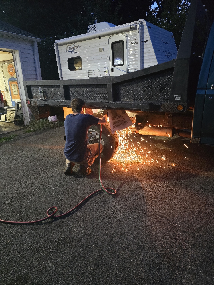

It just so happens there was a 2500 dollar 1996 ford f350 with a 7.3.... mint, Trish contacted the guy and it was just what we needed, a running driving truck with a junk cab and flatbed. 2k dollars later the first piece of the puzzle was secured. Friday of that week we picked it up and the disassembly began. Within an hour the flatbed was torched off and ready for the scrap yard. Next was the shitty part of removing all the wiring without cutting a single wire. Everything was assumed necessary for the swap. Many hours later the cab was removed and we were left with a frame, and engine.

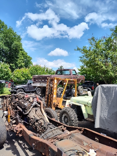

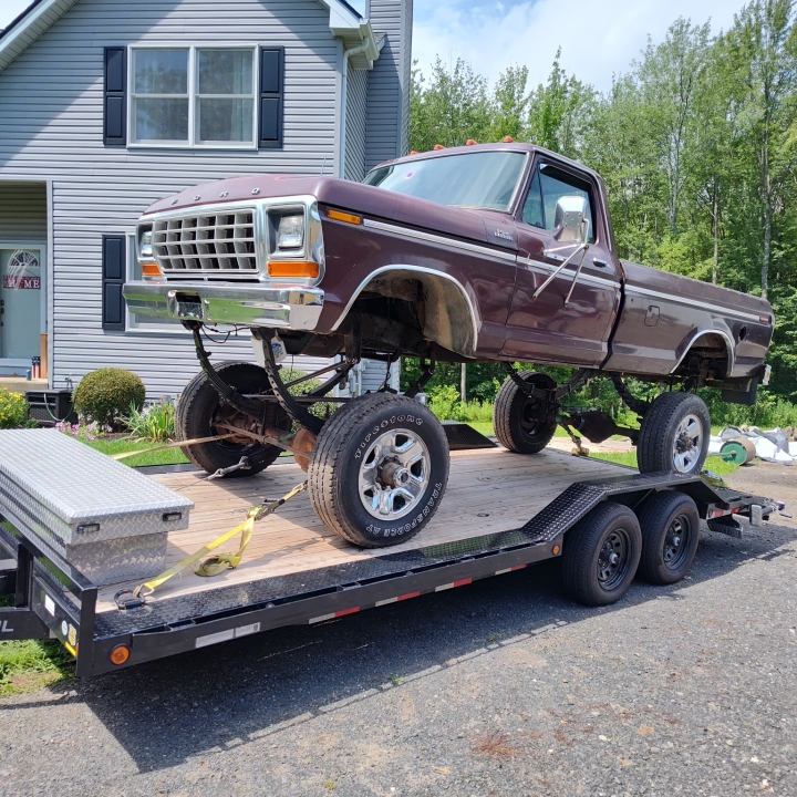

So with a rolling chassis, I kept myself busy removing a lot of unneeded brackets and bits, along with 2 bad exhaust manifolds, and a bad shackle on the front axle, although it's crusty it will work perfectly. The next part was figuring out the body side of the project. The free truck didn't have a bed and that was kind of a pacing item to set the ride height of the cab. This is where the project went off the rails, Donny had jokingly sent an ad for a big brown truck. But it was 10k at the time..... And it was way too big. Well a couple weeks later the price dropped, so Trish contacted him. After talking with him I decided it was worth the drive. The truck was big, but because he never finished the project the body was as clean as one could ask for given the year. So we haggled and I opened my wallet.

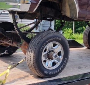

A huge thank you, and I mean huge ! To Donny Jarrett and Alan for helping me out to get this thing home. I believe phrase that sums up this project best is " you didn't tell me it was original bigfoot big " the tires are 46" 19.5 wide

So this pretty much brings us to current, the frame of the 96 now lives under the body of the 79 while the rest of the cleanup happens and the body mounts come in from LMC. Once that happens, it will be time to start fitting the cab on the 96 frame.

To the little part I have had my hand on it’s been a ton of fun, the pictures don’t do justice of how tall the truck was till your standing next to it
Yup, gonna be watching this one.  Damn look at the bend in those leafs!

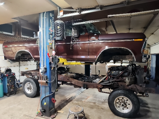

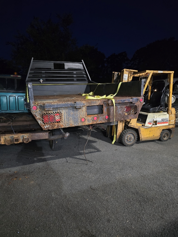

I had spent every free moment in the garage leading up to the big weekend, prepping, cleaning, measuring, and remeasuring everything. The plan was to first remove the truck bed off of the 79 frame, and then place it onto the 96 frame. once that was done the cab could be moved over. Simple Right ?
The first hurdle was that the 79 frame and body was not a roller, it was essentially stuck on the car lift, thanks to Donny and his little trailer ( MVP of the weekend ) the plan was to put the entire chassis on the trailer and move it forward enough to remove the bed with the car lift. It didn't work that way, The car lift arms don't go high enough.
Switching gears, we ended up using the forklift, and very carefully maneuvering it into the garage and managed to get the alignment perfect. with some careful rigging, and some watchful eyes the bed was off and the truck could be rolled out of the garage, and then the 96 frame rolled in.

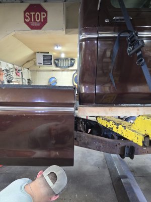

With the bed on the new frame it was time for the cab, the 79 rolled back in on the tiny trailer and the cab was lifted off with the lift. much easier ... until we realized the cab all the way up, barely clears the engine. with the old frame and engine out, we could roll in and position the cab on the 96 frame. with some maneuvering, the cab set right down. It was supported by the lift since none of the body mounts would line up.
After the stress of all the parts moving had subsided it was nice to know none of the body panels took any damage, and almost everything lines up quite well with very few modifications.
