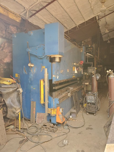

and with the help of a press brake larger than your living room,

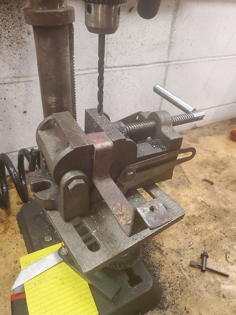

he was able to bend 3/8%u201D plate to the specifications I had asked for. After some minor drilling, reaming and grinding Viola! A mount for a JK brake caliper.

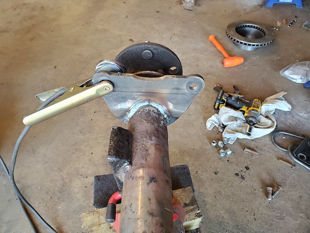

I then ground things down for final fitment with the help of a few people to help eyeball things. I then asked a friend who is a certified welder to actually do the welds because I trust his welding ability over mine when it comes to things like brakes!

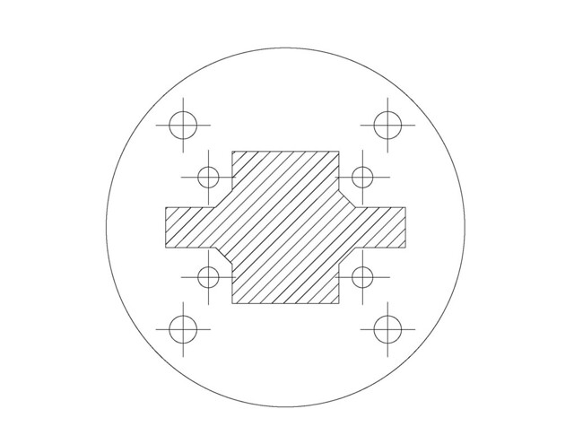

Looking at the specifications for a professional transfer case brake it was not dissimilar to the setup on an ATV or dirt bike, so jumping on Amazon I was flush with Chinese brake rotors and calipers. The next hurdle was to figure out how to mount it. I needed to fabricate an intermediate plate to mount the rotor to the yoke of the transfer case. With the aid of CAD, a pair of dial calipers, and set of reamers, a mill drill, a lathe, a file, and patience, I developed this intermediate plate.
It fit the rotor very well but there was some misalignment when it came to the yoke of the transfer case. I decided that instead of machining the back faces of the yoke that I would install washers to get the plate (and now rotor) to mount nicely to the yoke%u2019s back face (non machined except for the counter bored areas). All said and done, I ended up with .005%u201D of runout from the face of the rotor so I will call that good.
